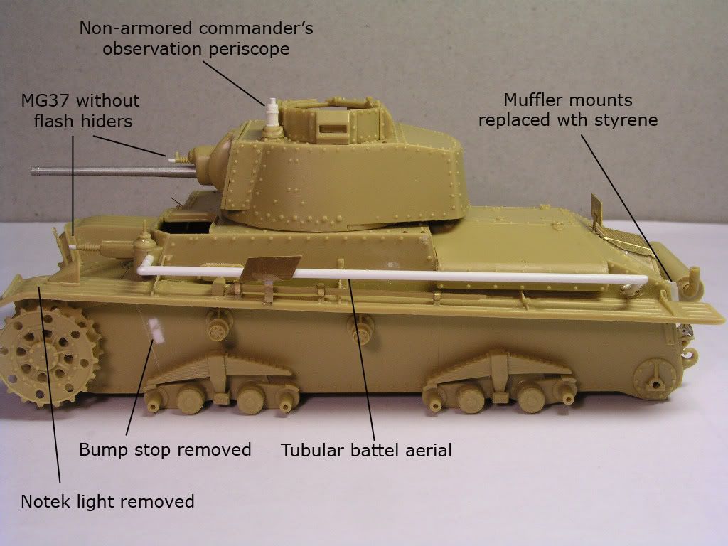

I present my latest build - backdating Tristar's PzKpfw 38t Ausf B to an Ausf A.
This is probably one of the simplest conversion and very enjoyable. Some of the things that need to be done are:
- adding a tubular battle aerial
- un-armored commander's observation periscope
- relocate front and rear fender reflectors
- MG37's with no flash hider
- shovel and pickaxe stowed across the engine access hatch on the rear
- no notek light and convoy light
- no bump stop behind first roadwheel
- no rain guard above the sight aperture
- no mounting handle on left side of turret and upper hull
- no stop for turret MG
- narrower roadwheels with thicker steel bands
- early type tracks with solid guide horns

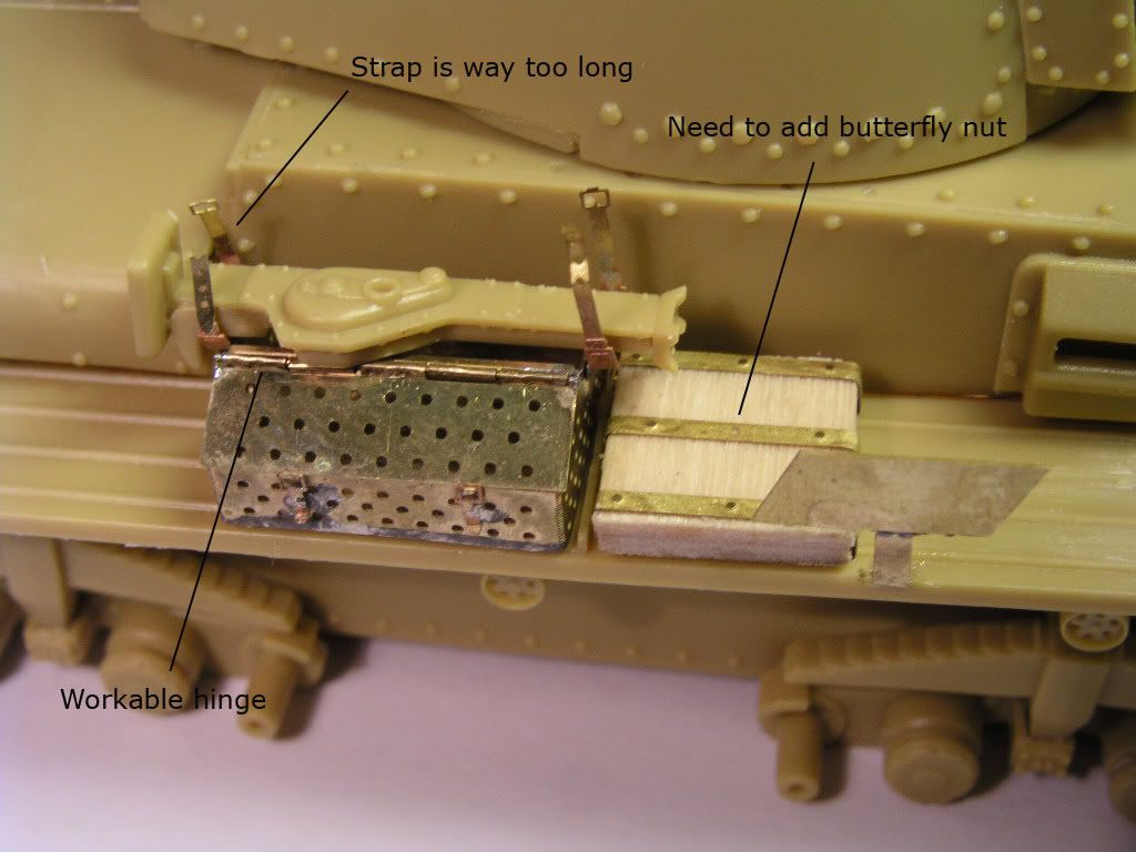

Close-ups. I love those Tichy rivets
The rear strap for the jack is way too long and I will need to cut if off, shorten it and solder it back on.
I am not going to thin the rubber tire as I don't think it will be noticeable. I will use the Tamiya roadwheel as it has thicker rim.
