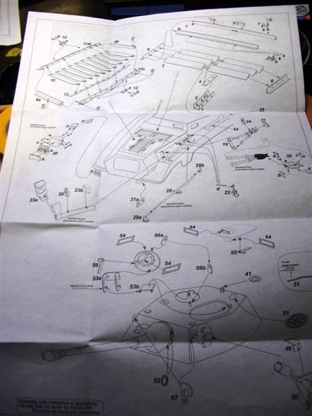

This Puma isn't bad but it needs some additions to make it shine. Eduard has PE set for it but as it doesn't add anything too difficult, I'll try to do similar parts my self.

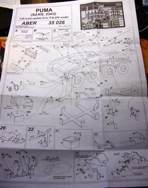

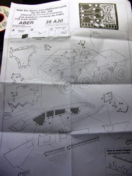

I have Aber PE sets for Italeri 234 and I will use thos instructions to add details. It's quite astounishing how Eduard PE in 72 scale is almost same as Aber in bigger scale.
I haven't really looked into model yet so I don't know what excatly to expect. Christopher's 234-blog helps a lot, thou
Here are instructions:

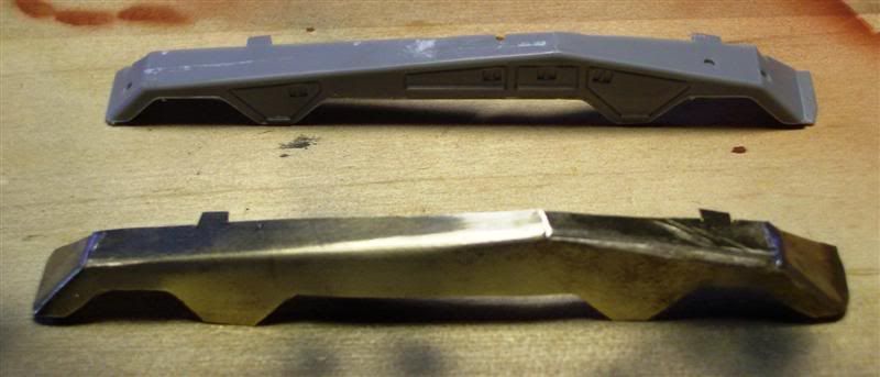

As I'm hassling into all directions with this, I started doing fenders from scratch. This is first version without side bins. Corners are off and too round. I laos noticed when looking at pic that I can't bend metal part over original one as it won't shape correctly then. Just trying to get feel of the work I'm heading myself into:
