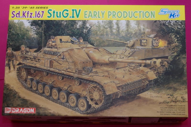

DML Sd.Kfz.167 StuG.IV
Hi Folks,
It has been a while since I have worked on our vBench for the last time. Hope to be back with some old and new projects. First of all need to finish my Stug III G that I started the Group build with and than along with it a new StG IV project. I just could not stop myself from buying this new DML StuG IV kit as I think it can be a very good base for 1:35 StuG model of the StuG IV that was recovered from Riglewka River and than restored restored in Poznan over last 3 years. I am sure the story of this StuG is well known to many fellow modellers since it was populair subject of discussions at many forums.
This particulair StuG IV is the late version and was in use of 2. Kompanie Panzerjäger-Abteilung Brandenburg /1. Jäger-Rgt. "Brandenburg". It sank when on 18/19 January 1945 ice covering the Riglewka River broke down under its tracks.
As the new DML kit represents Early Version, it will need many alterations and some aftermarket items to convert it to something remaining the original thing.
I do not have my own pictures of this StuG as unfortunately was not able to go to Poznan so far to see it and photograph it, but it was very well photographed and pictures are present at Polish exploration and modelling forums. I'll use some of this pictures from the web to explain changes I'll be making. All pictures will be published here for discussion purposes only and hope pople who made them will not become angry
To start with the lower hull - it is perfect for modelling this particulair StuG IV as it represents Pz.IV Ausf.H lower hull with 4 return rollers. So no changes needed there.
