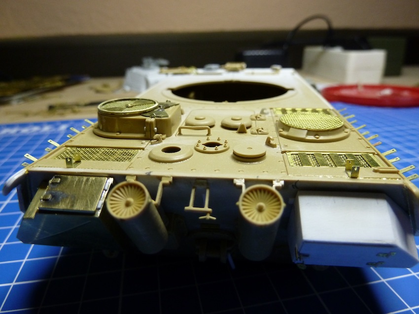

For many years I have been following the threads on this website and am thrilled.
My Favorite vBench is Larry Bates Tamiya Panther G from the year 2005.
I decided to build the kit also. I consider myself close to the tips and tricks that Larry needed for the construction.
At that time the kit is approximately 60% finished. On the hull only a few small things are missing. I have not started to build Turret and Drive yet.
I want to show some pictures in the next days showing my progress so far and then live aboard in the further construction.
I have the following things for the building (for now)
Tamiya Panther G late No. 35 176
ABER etched update set 35 024
Griffon 7.5 cm L/70 Barrel No. KwK42. GMLB35016
Friul late Panther idler wheel AW-19
The remains of a Dragon Panther 6268, I received as a gift from a friend (I will here take only a few parts)
I raised the section in front of the drivers' hatch with some plastic card
cut out the parts for the commanders periscope from the dragon hull
cleaned and dry fitted this parts to the Tamiya hull
added some welds around the raised section. Installed both hatches.
had to scratch this hook with plastic-card. Bought the kit on ebay and it came with the broken off hook .... an the broken part was not in the box
So far for today. More pics to come in the next days.
Thank you for your interest and your critics of course
