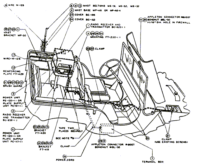

I first went to find some references of radios fitted to jeeps. Via the Missing Links Allied DG, I came across this website, www.armyradio.com
It turned out to be a real goldmine of information, and this page was particularly useful:
Manual for Installation of Radio Equipement in Truck, 1/4 ton, 4x4.
The result should be something like this:
Source: www.armyradio.com
After finding the necessary diagrams, and printing them out, I went to work on the jeep:
I decided to leave everything in sub-assemblies, to make painting easier. This was also necessary to wire up the radio. I still need to add the wiring that goes to the transfer box, fitted under the passengers seat. In between building, I testfitted everything, and it did fit

Here's a photo of the SCR-510 is fitted to the back of the jeep. The mounting I used came from Eduard. Tamiya's radio has the mounting moulded on, so this needs shaving off. The brackets for the radio are simple pieces of steel strip. See picture:
