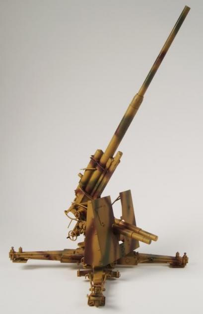

Super detailed 8.8cm Flak 36/43 (DML Flak 36 kit): WIP
This is the 8.8cm Flak 36/43 which was the standard 8.8cm Flak 36 but mounting the L/71 barrel from the 8.8cm Flak 41. I received duplicate one in error from Cromwell models who makes the Flak 41. I machined off the retaining strap and replaced it with styrene sheet. Besides this, I added bits from the Lionroar Flak 36 PE set, the upper recuperator armored housing from the DML Flak 37 kit (the only known picture of the Flak 36/43 shows this item), and I added wiring, bits and pieces as I saw fit. Almost ready for paint. Still a few items to install but mostly done. Some parts aren't in their final position (like the recuperator cylinders) but I need to be flexible to paint the complex assemblies.
Any questions and comments are welcome. RC
Note the extra long gun tube!
