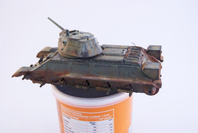

Hi everyone. This şs my new scrap one, Russian T34/76.
I replaced some parts of the kit with copper cable and I applied some Mr. Surfacer to tarret, front, back, left and right sides of hull to make a surface like diecast. Then I painted the whole kit with Mr. Surfacer 500 and then German Camouflage of Vallejo to gain a scrap seurface after using hair sprey method. But after applying hair spray and painting the kit with Vallejo's Russian Green I couldn't apply the technic properly so I used sponge technic to form chip surface and then I used some pigments.
I am going to start painting tires soon.
