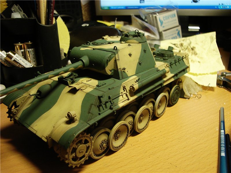

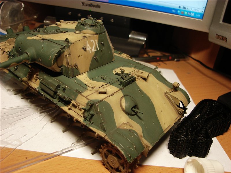

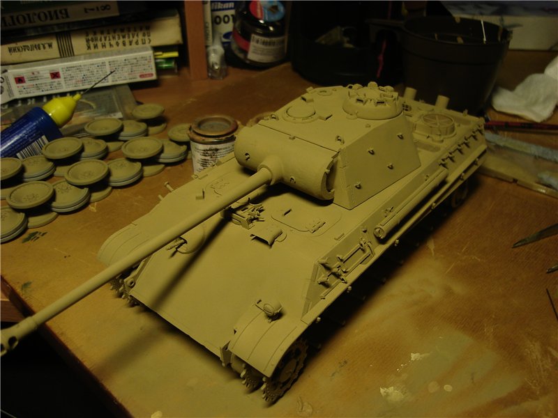

Assemblage good - gathers on hurrah, but in conformity to a prototype there are some bad places. Here that has corrected:
1. Has ground off wings till the necessary thickness, but внутренюю a part of lobbies предкрылок has made of a tin.
2. Has cleaned welding between the case and plates over fans.
3. Has cleaned a jamb of a motionless part of a mask. It is necessary to cut off a threshold behind a cube almost on is not present.
4. The hatch on a tower forage will shift more to the left. The error makes 1мм that in the real sizes 3,5 see Has ground off on the left side and has added справой with the help шпатлёвки.
5. Has made roughness of a command turret. Has put putty with blanks, and has then ground a skin.
6. Pins for fastening spare tracks on a forage of a tower from a wire.
7. Fastening of a shovel, an axe, a sledge hammer, a breakage, a curve starter, fastening of exhausts — a tin from banks from under aerated water.
8. Locks for tool fastening — P.E. parts Loin Royer.
9. Tracks — MasterKlub.
10. Has made asterisks and idlers turning.
11. Has made possible opening of hatches of the mechanic-driver and the marksman-radio operator, having made workers terminators of opening of hatches.
Painted with enamels of Revell and Hambrol, and also oil the Neva Palette. At first has put base a mix of different colours of Revell and Hambrol (1), further a camouflage, besides a mix, has blown into numbers on self-made cliches, washing Umbra Natural Leningrad (2), after splits - light base enamel, splits a mix of Umbra with something (3), a rust - a mix of different oil paints red and корчневых shades, same aged spare traks, a dirt имитироdал soda, has then painted a dust and a dirt some approaches with different oil paints (4), as well caterpillars. Further acting parts on caterpillars and rubbing parts of all-metal skating rinks "has painted" with a pencil. In the end has made поддётки oils (oil) and has blown into all a matte varnish of Hambrol.
