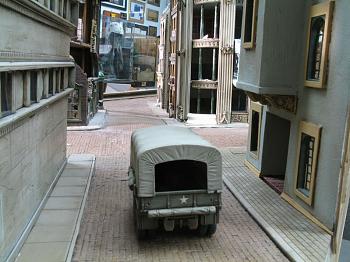

I set a deuce and a half in the street to give some perspective. I will be putting pounds of rubble throughout the dio.
