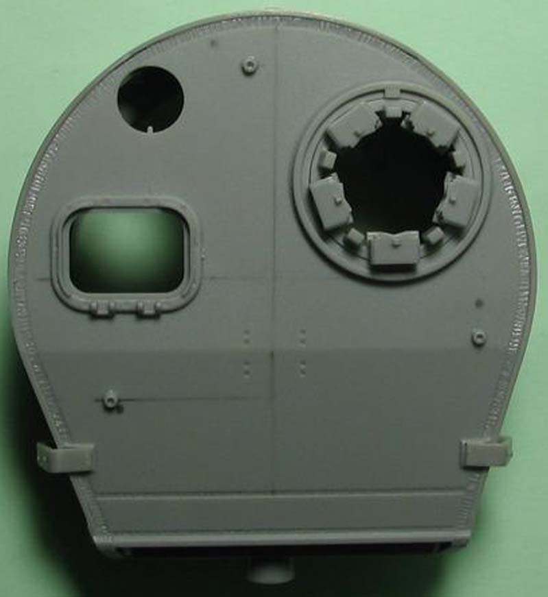

I made this Tiger(P) in the year before last. And now I’m showing this photo albums in my weblog, but I decided to also show these in PA by the advice of you.
I made this as No,003 (only one actual fighting deployment type of Schwere panzerjäger Abteilung 653) I spent about 1 year for making this,(Because an exclusive PE parts was not released) and there are many photos of progress. So I will introduce this progress for several times.
These points are revised in a premium edition, but these processes are necessary for making original edition.
The position of vision port's slit of DML's kit is necessary to lower 2mm as shown in TigerⅠinfo.
I use unnecessary parts (E-15)
I add Escape Hatch at the right of turret. So the part is converted from TAMIYA 's TigerⅠ early version, I made a hole according to part of TAMIYA.
also put Pilze on turret according to Tiger Ⅰ info.
