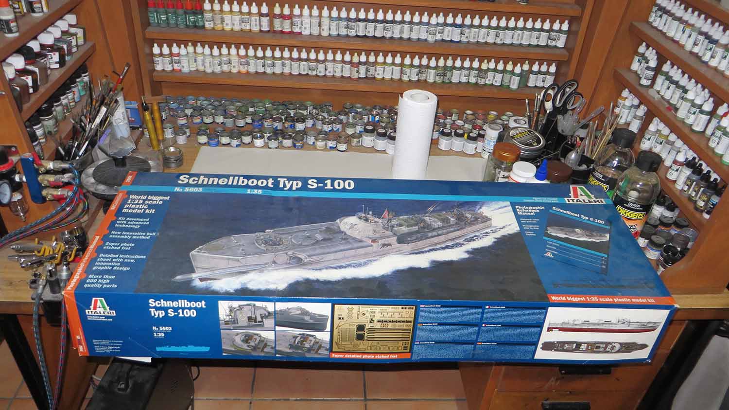

Italeri Schnellboot S-100
Hello again,
It's been awhile, I had got bored with beer bottle decals on the Takom King Tiger diorama and needed a break.
I give the Kudos to Fledermaus (Abdin) to help me move forward with the build.
Thank you for the plethora of information and spare parts. Especially the forward gun ring
It has given me the inspiration to commence a very large project and it is not the first time on commencing a build which consumes most of the workbench.
The Schnellboot build will be shared along with the King Tiger dio. Splitting the efforts between the 2 will be the challenge.
It is the biggest or shall I say the longest box in the stash and at the moment and I have big desire to build something that floats and to work with creating a water scene.
Metal barrels for all weapon platforms along with the Eduard Big Ed set, 10 of the Azimut resin figures and the Italeri boat crew.
The plastic figures will have head and hand conversions by hornet
Here are some progress shots of the sub sections.
Michael
